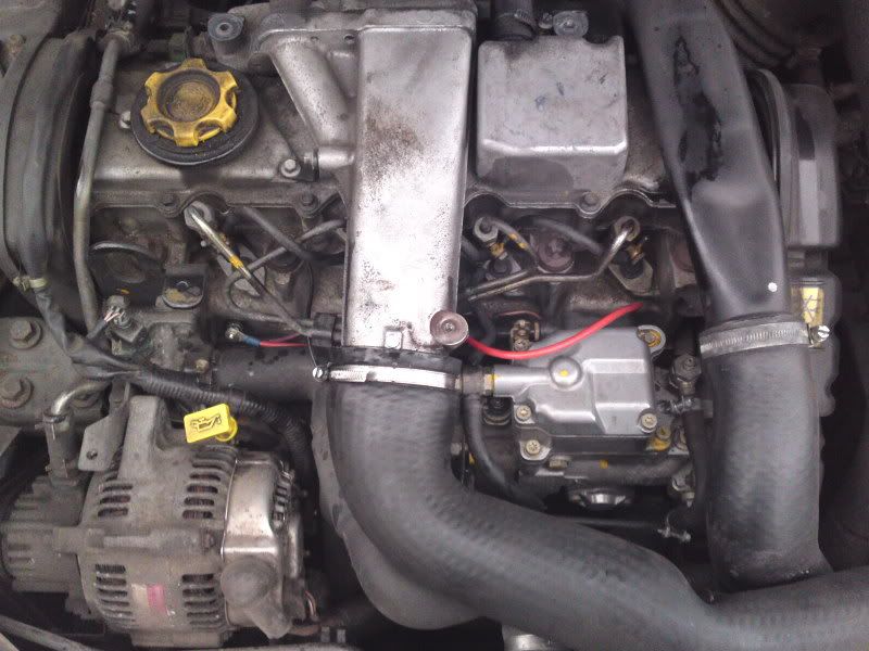

 Post subject: Re: rover 400 td issues
PostPosted: Wed Mar 17, 2010 8:53 pm
3633
Wheres the engine cover gone! :D
That is the Di engine with the VP37 pump
Info on what you want to do should be on my website.

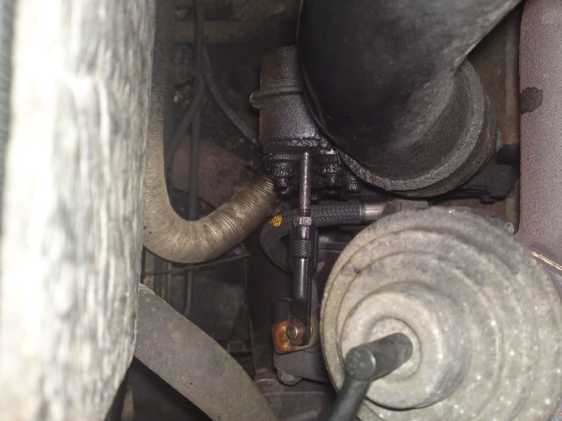

two things really
where do i connect the boost pressure sensor to find out what its currently running and to monitor it as i adjust it ???
secondly
after looking closely at it like so
there doesnt seem to be alot of adjustment on this theres only a couple of turns left by the looks of things
also i guess i do wanna make it shorter not longer ??
PostPosted: Sun Mar 21, 2010 11:13 am
Tue Mar 07, 2006 7:57 pm
6242
preston lancs
shorten it
