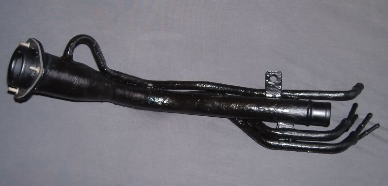

800 filler pipes rust badly and have been NLA for years (they were £200+VAT when available). It's a problem best sorted before you start making puddles on the petrol station forecourt and find your tank is full of rust.
I refurbed one for my own car a while ago and thought I'd offer it up as a service.
What's done:
Clean and degrease (natch)
Electrolytic bath to remove all corrosion
Any structural repairs made
Zinc primer for corrosion protection
Coated in polyester resin with filler for strength
Sealed with black gelcoat
Pipe connections painted and foam rubber gasket fitted
End result is far more durable than new.
Fit's all Mk2 800's and should also fit Mk1's (need to confirm)
Price: £60 outright sale. I'd also be interested in buying back your original filler if in a suitable condition for refurbishment.

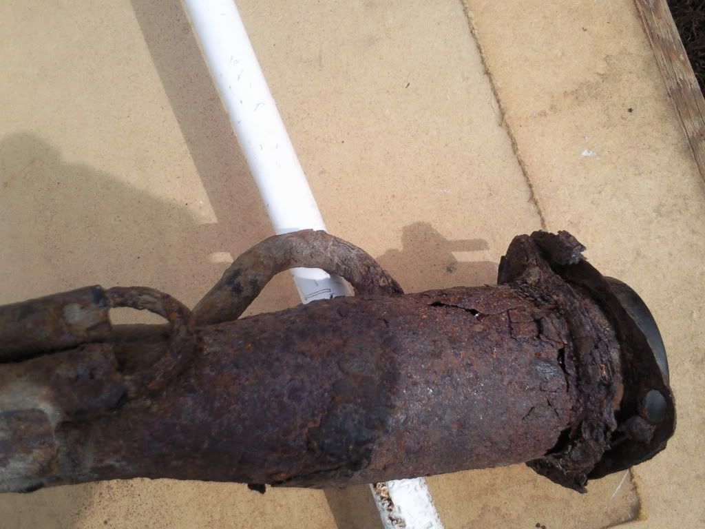

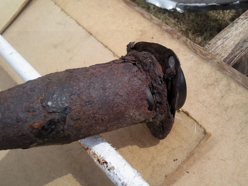

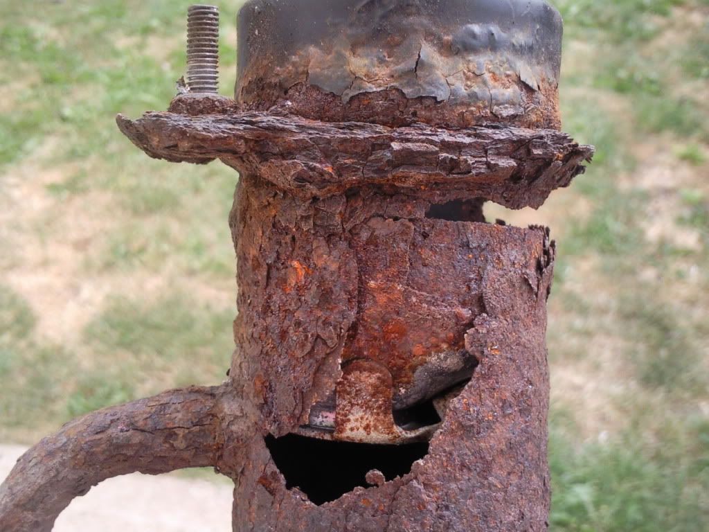

Thought i'd throw my two-penn'orth in, even though i'm hardly ever on here! Been wondering why my fuel economy was suffering lately and why i could smell petrol quite strongly almost all the time.
While changing the rear pads recently i noticed the filler neck looked a bit rough so decided to take it out and have a proper look today :
Doesn't look too bad, even though it's holed :
So i was hopeful of just patching it to get me about until i could get a good replacement until i saw this after giving it a bit of a rub :
So it's fire up my "ark" welder - yes it is an arc welder and it's so old i reckon Noah had it as a boy but it works! I've got some thin wall steel pipe just about the right size so fingers crossed!
Reckon it's time to look into alternative materials for this item though. Stainless would be nice but expensive. Aluminium might be an option or perhaps even brass or copper.
Once i've fixed this one enough to make it usable, i'll take some drawings/measurements. Of course, the main problem is that whatever it's made from (except stainless) is likely to corrode as it's a total mud trap where the top of the filler neck lives. Perhaps the answer would be a stainless filler neck then a rubber hose down to the tank without the steel down tube - just rubber all the way except the filler itself. Ideally something like glass-filled nylon moulded into shape but that's a lot of work and money for a one-off and i don't have an injection moulding machine!
