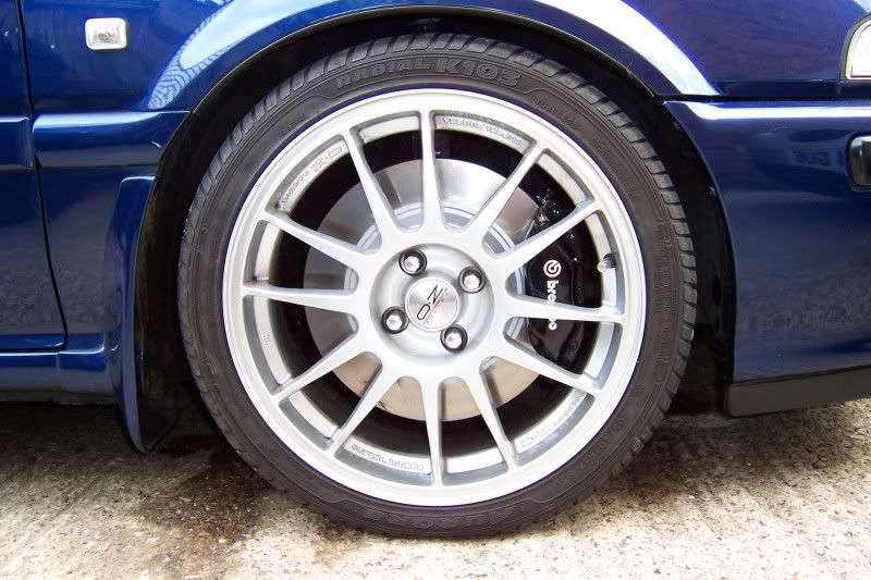

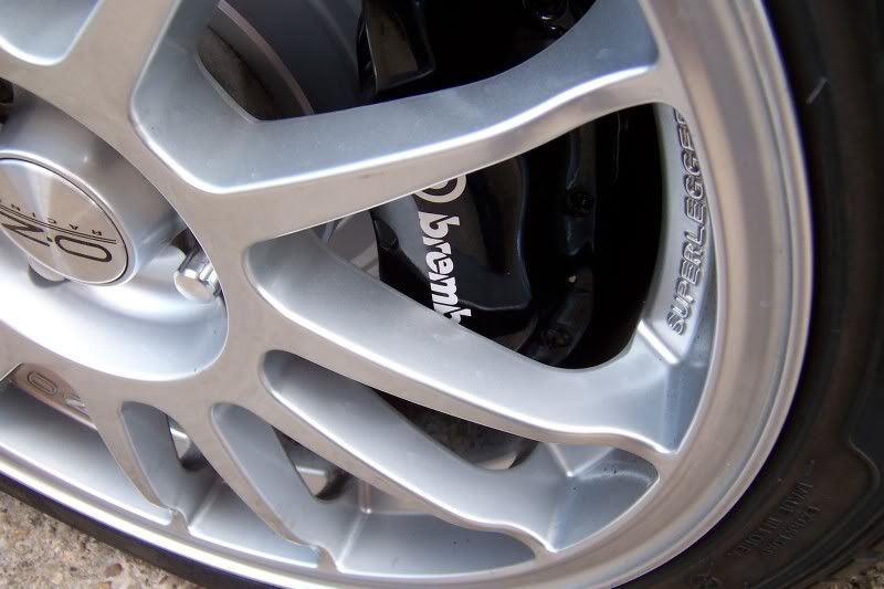

Photos as promised:
And a close up of the brake/rim clearance for the benefit of Rob

Those look great Tom.

what was the clearance like on the pro race 1.2's if anyone knows
17"
Car status:
'93 220 GSi Turbo -Gone
'95 Metro GTa -Dead
'03 25 -On the road
'70 Dodge Dart -In the garage
 Post subject: Re: ttrw2 2/400 Brembo Big Brake Kit
PostPosted: Tue May 25, 2010 7:41 am
Thu Sep 11, 2003 5:00 pm
12752
DTEC - Mpumalanga, South Africa
Tbh.
Sc4mpi wrote:
i can just about get a £1 between the caliper and the spoke.

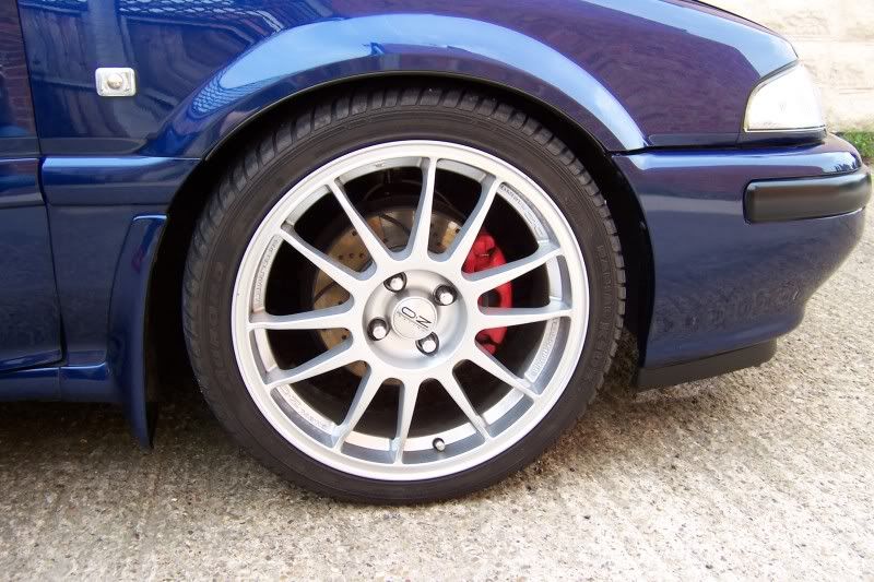

Finally had some time to fit mine today :D
Before
After
Just enough room to get your nail between the spokes and caliper
Fitting went quite smoothly, the only problem i encountered was with the spacing using the shims, when i used all 3 it pulled the caliper too far in and it touched the disc, when using 2 it went too far the other way so i used 2 plus 1 of the thinner ones which were in the bag with the banjo bolts and it fitted perfectly :D
Amazingly the braking feels much sharper even with new discs and pads, although the peddel is abit spongy, i've only beld it twice so far, so i know i've still got some air in there but i'm going to put a few miles on it before doing another.
