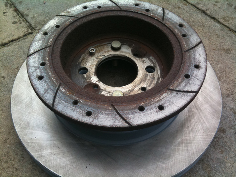

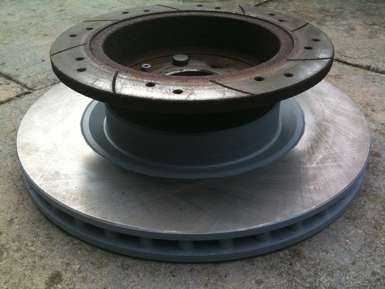

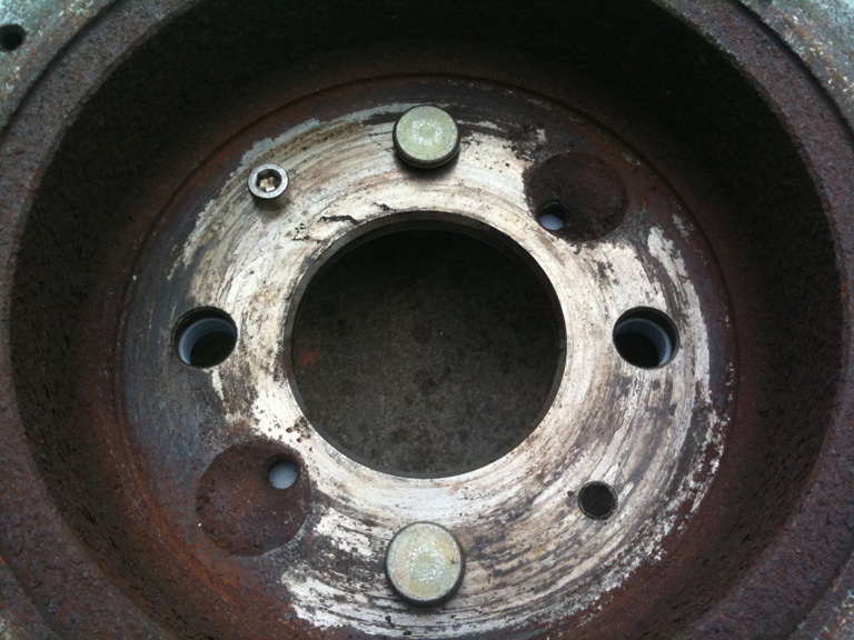

Mitus wrote:
Thanks for the updates guys, anyone who has the Brembo's already fitted, could you confirm you can see/get to the M6 thread on the drive flange for locating screws?
I can confirm the M6 countersunk bolts WILL go straight through the larger bolt holes on the Brembo group buy discs, so no drilling of these discs is required. (Note: I only have the non-grooved discs, if someone with the grooved version can confirm there are 8 bolt holes in them, they should be fine too)
Old disc on top (albeit a rear, but the same PCD and countersunk hole position), new Brembo group buy disc beneath, two wheel studs in place, and an M6 bolt drops straight through the disc retaining countersunk screw hole, through the larger wheel stud hole in the Brembo disc, and out the bottom.

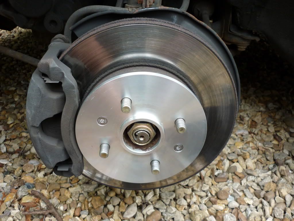

I have the spacers :D
I'd rather add the extra locating holes and countersink them at work on the pillar drill, but I'm off work until next Wednesday. If you're not fussed about the extra holes or have the facility to do them yourself, you can of course have them now as they are. Those who have declared an interest can you please PM me with what you want to do and we'll go from there.

Got mine today, look top notch, well engineered bits of kit. Have posted in your vouch thread.

He sent me a pair of his new spacers which I popped on the Coupe this morning (std 262mm brakes > need the spacers to run 282's under the std Turbo alloys).
They fit perfectly - the geometric tolerances are extremely tight and a very professional, well-engineered bit of kit. Grub screws are a nice touch too, I have to say :)
Fortunately, with std Coupe Turbo wheels/wheel studs there is 7.5 turns on the wheel nut before it goes tight. Enough for me!

Fitted mine and they are great, Ideal for clearing brakes but not so wide the tyre doesnt fit under the arch. Could of done with these 10 years ago!
Tried 3 sets of wheels; stock and normal after market fitted great. Silly rims with deep lip dont however, but thats retard wheels fault and my 16mm spacers dont even clear them.
2 small probs tho are I found the fit a bit tight, my other spacers fit on and off with no effort, these needed a bit persuading over the studs.
And they have quite a large diameter, so cover half my bell :whistle:
Im also guessing they are moduler in that if you want to go wider you can fit them over each other?

Jase, stud holes have been enlarged slightly since my first original pair, which slide over the studs nicely. It's possibly just slight differences between vehicles. As for the diameter, they were made that size to suit Rob's Brembo conversion and match the bells of those discs. I could have had them reduced if you'd said :wink:

... small probs tho are I found the fit a bit tight, my other spacers fit on and off with no effort, these needed a bit persuading over the studs ....
Indicating a well-made transition fit and not a sloppy clearance fit! :)
