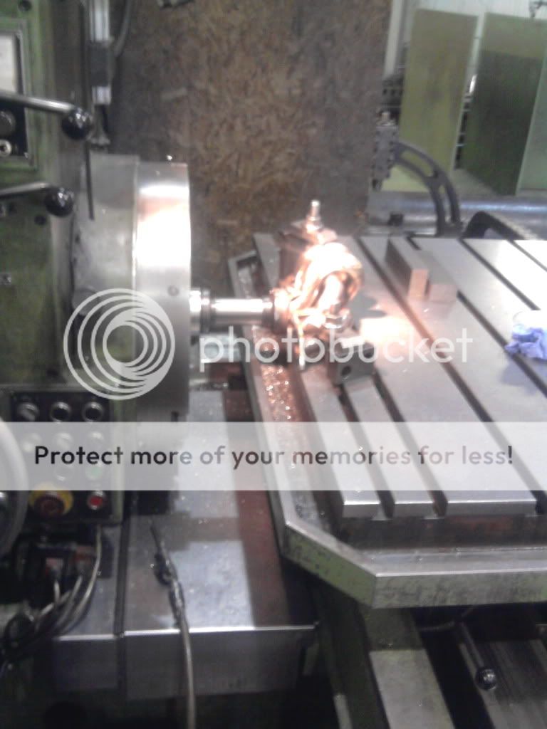

Hit me for two but if they end up being bent like a banana like my other one supplied via Rovertech then I'll bring them back personally :wink: :lol:
After you make the manifold, get it skimmed :wink:

had to skim 0.8mm off mine, did it the other week at work. Sorry pics are abit crap :(
