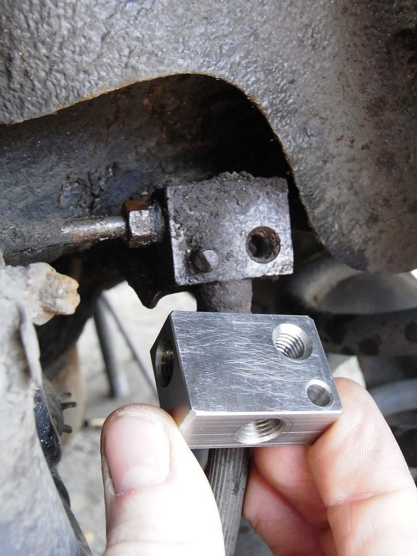

I assume no one has fitted their 800 kits yet? Because the block connector for the N/S rear is wrong - the connections are in the wrong place.
I've got a photo, which I'll upload tomorrow. Hopefully we can get a replacement sorted.

:| I think it could be interesting at this late date, did nobody check them at all?
What's wrong with them, is it anything that could be adapted or remedied or is the block totally wrong? Are the pipes OK, would it just be a case of swapping the block? Any info would be good Ant, give me the full details and I'll fire them off an email.

I had another look today after giving it some thought last night. The pipe connections are effectively in right position, but the mounting bolt hole is incorrect:
The bracket the block attaches to is bolted to the chassis, and it looks like there's enough room to remove the bracket and drill another hole through it to suit the block.
I should be able to give this a go next weekend. So hopefully the existing blocks will be usable, but HEL ought to be aware because if they sell kits in the future they won't be plug and play.

FFffuuuuuuuuuuuuu :facepalm:
Considering they had the flipping originals to go by as well. :x
Thanks for the info Ant, I'll email them across the picture and let them know, it almost looks like the block is reversed. Out of interest does that screw thread in the face of it do anything?
Brake spanner is 7/16, a touch smaller than 11mm. Worth getting a proper brake spanner tbh as they tend to be wider than a standard spanner and spread the load a bit better.
Sorry for mess, I best contact anybody else on the list for 800 hoses and let them know.

Thanks. I'm going to get some of those almost-ring spanners that slip over the pipe and then go on the nut.
The threaded hole (M6 IIRC) takes the securing bolt which passes through a plain hole in the bracket from underneath. The plain hole in the new block is unneccessary.
The original blocks have a locating peg which locates into a hole in the bracket (it also sticks out the top of the block (as you can see in the photo) for some reason). There isn't a peg on the new blocks, but this isn't a big deal IMO.
I don't know if these new blocks were custom made or are from something else, which might explain the differences.

Ahh right, I see how it works now, cheers.
I think the blocks are from something else tbh, as they were waiting for a batch to come in when I spoke to them about it, and they mentioned then it was the same as something else - or maybe not as we now know.
btw, just thinking about the spanner there, actually it should be metric - mine is 10mm and 11mm IIRC, but I've often found a 7/16 spanner is a closer fit when they have rusted a bit - unless the fittings on the 800 are actually imperial, but I can't see they would be. Either way the proper spanner gives a lot more confidence as it grasps a lot more of the nut. I've double up on spanners as well before if one has started to round.
