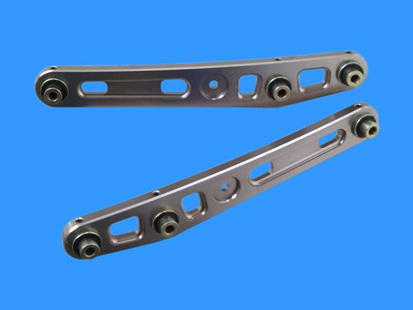

I've received mine today. And looking at it I think making the forks wider is a better option. As keeping the bush the correct size is a better job and will last a lot longer etc.
I've got some spare shocks. Plan is to simply bend the forks out. Slide a metal box section in the correct width and bend them back around it.

will these not give the same issues or have moto-build done something different?
MB ones seem to be a different design.
http://www.moto-build.com/
What makes these different and anyone used these before? could help resolve the skunk2 ones
The moto-build arms below are a little different to the image above
Just remember that in doing this you'll lower the car at the back a little (~5mm) as the shock body will effectively be shorter when "adjusted" to fit.

E_T_V wrote:
Correct but is a bonus I guess as I wouldn't mind it a touch lower :)

VVC MINI wrote:
E_T_V wrote:
still wont cure the problem of having a in correct size crush tube . so it will effectively be lose fitting in the bush.
and thats fine if ur doing it to old shocks. if any one has new konis or coil-overs ur void the warranty.
also means if you change suspension ur had to do the same mod to every shock .
im still in favour of swapping out he bush for the superflex one

Just swap the crush tube for a better fitting one or bush it to fit?

Ye just put a bigger bolt in.

I used Superflex tubes with the Skunk bushes

I have arms not that dissimilar to the moto-build ones and had to trim the shock mounting bush down to size. That was easier than these arms because the crush tube was wide enough to be trimmed to size without affecting the bush itself. I'm pretty sure I changed the bolt too and all was fine.

Wow what have I missed since I got mine! As you can guess I have not even got around to fitting mine. Interesting reading for sure and not really an issue is it chaps.
Seeing that I have not stripped mine yet can anyone tell me what size the boss is across on the standard arm position?
When the Skunk bushes were removed, in two halves were they?, did they fit face to face or was there a gap? i.e. when pressed in to the head of the bush did it go exactly halfway so both bushes kissed in the middle? If there is a gap good, just reduce the boss and drop the bushes in by half each side. If no gap then reduce the smaller diameter end of the bush and the tube.
Personally I would be looking to achieve the same fit for the fork, same thickness of the headed bush and reduce the boss width so you have full compliance of the head of the bush so as to retain the lateral clearance. I would not be happy with skimming the head of the bush down as this will end up shearing in no time.
Seeing as my zed is being sorned this week I may be taking my arms off sooner that expected in order to see what's the best way forward. I won't be butchering mine, it has to be right as it is no fuds car! :wink:

I'll know on the 8th and will have a workable permanent solution by then and will offer the modding service at cost to any body that wants it. Assuming its doable etc
