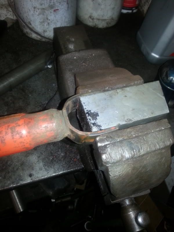

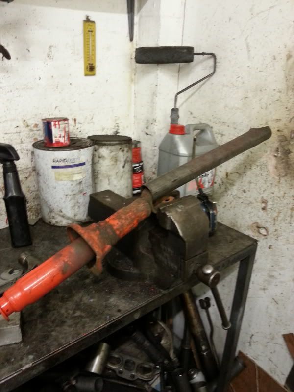

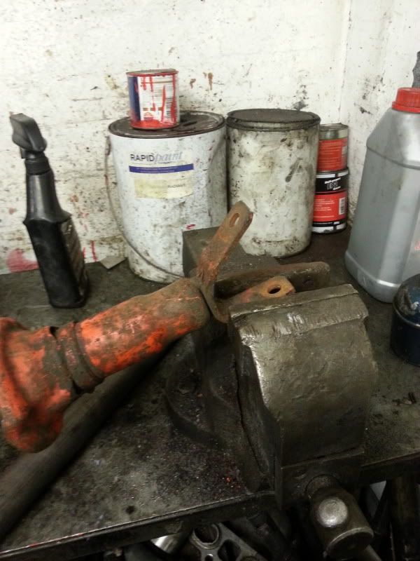

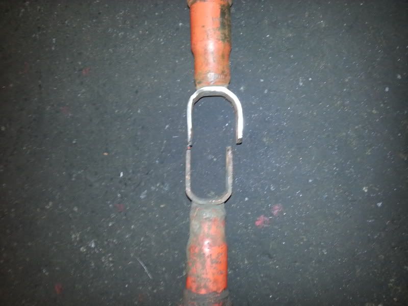

Modded some shocks. 20 minutes to do including cleaning them up.
Before, after
Put in vice. Then bend the forks out. Do not put shock tube in vice as will damage it.
Bend both of them out.
Get something hard around 50mm wide and bend the forks back.
Simples.
I've had them on the car and all is good. No knocking or banging and a better job as the bush is now bigger then the stock rover one, so will last longer and a better ride :)

Much happier doing than than cutting thing off.

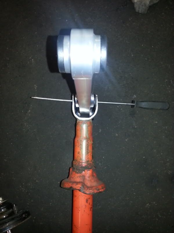

first problem . skunks are dead straight ( well actually they arnt they have a slight and i mean a slight bend in them well james set does anyway . ( put this down to not so good machining )
second problem related to the first
the oe ones are defo off set and have a kink in the shock mount . :wink:
now i have posted my OE up to andys so he can measure and give specs of what the difference is .
personally i feel i may have just bought a very expensive set of paper weights. but ill see what the machinist says when he compares against the OE One.
solution to make them fit remove the bush . take some off the inner bush and machine the face on both sides of the arm down . their is enuf meat their so shouldn't be a issue.
then will be able to just push the oe bush it came with back in .

The kinked section is no problem, you just turn the shock lower fork to fit the new arm, I can't see from the pics if the inner and outer end of the original arms are offset from each other or not.

Just need to wait and see if the middle is in the same place relative to the ends. Look forward to seeing the results of the measurements.

no problem being straight in the arm on mine.

If you draw a stringline between the two end bushes the centre of the middle one is still on the same line so all you need to do is rotate the bottom shock mount to fit.
I was worried about this at first but soon worked out that there shouldn't be an issue.
