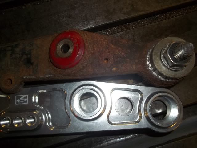

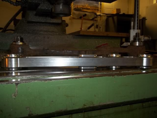

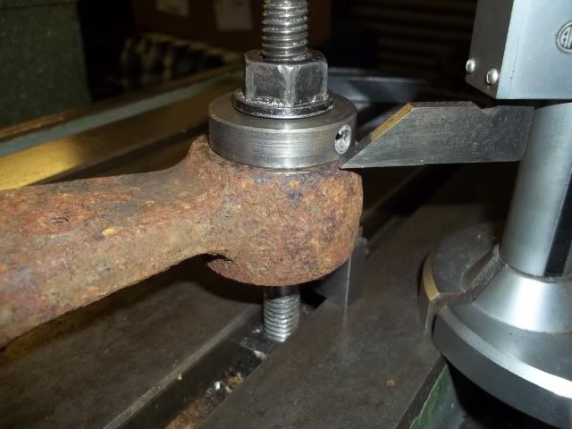

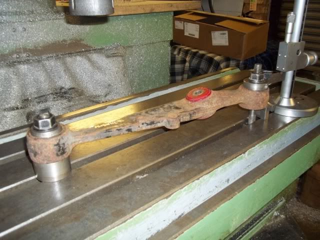

TAKEN ANDYS POST AND DUMPED IT ON HERE
As some of you are aware ,there has been a group buy on Rover Tech of some of these Rear Arms(Skunk 2).Its come to the attention that they do not fit the Coupe!!!.Basically the shock absorber bush is to large(50mm) and should be (40mm).I have looked at the Skunk arms and they can be Modified and still use the same bushes(split).This MOD can be done buy machineing the ally arms 5mm of each side and either/or, machining 5mm of the inside of the bushes or deepening the counterbore in the arm.The inner steel sleeves can also be reduced from 50mm long to 40mm long.There has been some speculation that the New(Skunk) arms are totally different to the old original ones,Therefore when fitted altering the whole Geometry of the car!!!!.So i decided to check and do some measuring.There are some Pictures and explanations below.
Set up original,and inner/outer are on same center line
Height same inner and outer!
Therefore outer and inner are in line!!
Aliitle drawing to explain the differance between the 2 types!
As you can see from the drawing the outer boss to the shock boss varies by 3/4" which would alter the shock angle thus changing ride height (Very slightly)
From my measurements i have concluded that the Skunk ones will fit ok when Modified.Al that you will need to do is spin the shock through 20 dgrees to slide over the bush!!!
C&C Engineering can Modify theese @£30 a pair, in batches of up to 10. batches of 11 to 20 @£25 a pair that doesnt include postage!!
