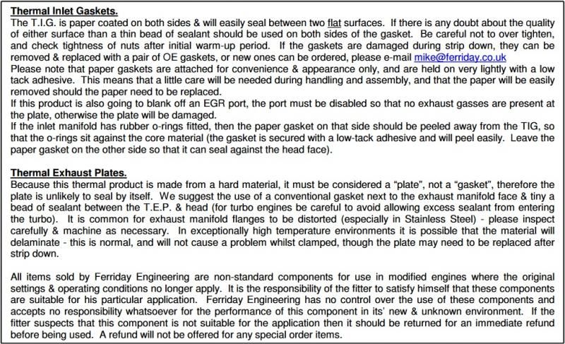

You will probably notice that they're in two halves, split down the centre line of the middle bolt hole. This is supposedly to make them easier to fit, although I can't see it making THAT much difference! It's certainly made them easier to package anyway :D There was more info at the bottom of the invoice, here is a screenshot so you're all aware:
Thank you to all who placed an order, I hope you're all happy with your purchases when they arrive - please post up a reply to let me know they've got to you OK.

Am I rite in thinking that I just fit the thermal inlet gasket as is,
So there's no need in removing the paper gasket either side? Just fit it how it comes without any need for a oe gasket?
As for the manifold I have a foil type and one with fire rings so unsure which route to take but thinking of going with the the fire rings one, am I rite in thinking that manifold gasket fits to the manifold then the thermal gasket then a bead of sealent?
Is anyone going to use sealent or just tighten it up without any? If using sealent which would be best as the manifold gets silly hot and not sure what's upto the job of sealing correctly
Many thanks Matt
 Post subject: Re: Ferriday Thermal Inlet & Exhaust Gaskets
PostPosted: Thu Dec 04, 2014 9:39 pm
Thu Dec 22, 2005 11:21 pm
965
As far as I can tell...
Remove inlet manifold,
Remove any traces of OE gasket from head & manifold faces,
Fit the thermal inlet gasket as it comes out of the packaging - do not remove the paper coating from either side,
Refit manifold.
Should the joint ever be disturbed again, it's then that you'll need to remove the paper coating from each side of the thermal gasket, then use an OE gasket on either side of it again when you reassemble. It's the paper material that actually forms the seal.
As for the exhaust, I just Googled high temperature RTV and got a few results, this one on ebay being one of them, says it's suitable for exhaust manifolds on the packaging. I'll be using some sealant if that's what Ferriday has advised.
Remove exhaust manifold,
Remove traces of OE gasket from head & manifold faces,
Apply high-temp RTV to one side of thermal plate and fit this side to head,
Fit OE gasket (I'll be using the fire-ringed type),
Refit exhaust manifold.
Studs & nuts are going to pretty much be a necessity over bolts! Don't forget that the purpose of the thermal exhaust plate is to keep the heat of the exhaust manifold away from the head. So the RTV isn't going to be exposed to horrifically high temperatures in theory :)

Having recived both the thermal gaskets I fitted my manifold one today, a little bead of gasket paste went on the thermal gasket which sealed to the head then them manifold gasket it's self,
Iv always had trouble with my manifold sealing properly,
iv fitted studs and lock nuts and gone as tight as i dare and I still get the slight tick which upsets me but can't think of anything else to do, iv fit the gbe gasket which isn't the foil type, it has the fire rings, so at a bit of a loss, I guess it's as good as i can do so just going to have to see what avails,
I havnt had it upto temperature as yet, iv had one before where I got a slight tick when just started but once warm it seemed to disappear so time will tell
